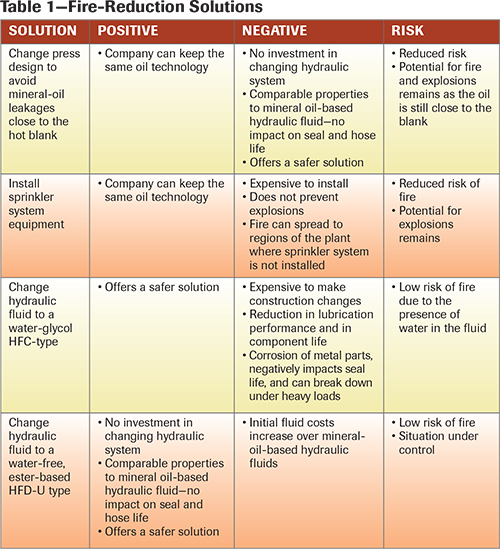

A case study shows how a conversion might proceed. The press-hardening lines at a large stamping company had experienced a number of fires resulting from ruptured hoses and leaking couplings that deposited oil onto hot work surfaces. In 2012, one fire resulted in worker injuries and more than one week of downtime, costing the company more than $6 million in damages. The gravity of the situation convinced management to take immediate action to reduce a fire risk. The management team solicited supplier proposals and evaluated available solutions to identify their best option from both a technical and financial perspective. Its approach weighed the positives and negatives (see Table 1—Fire-Reduction Solutions).
Management concluded that the safest and most cost-effective alternative was to replace the mineral oil currently used in press-hardening operations with a synthetic, water-free, HFD-U fluid. Though costing more than mineral oil, the HFD-U fluid offered the best overall value, lowering fire risk and improving safety without costly equipment changes or increased maintenance costs.
