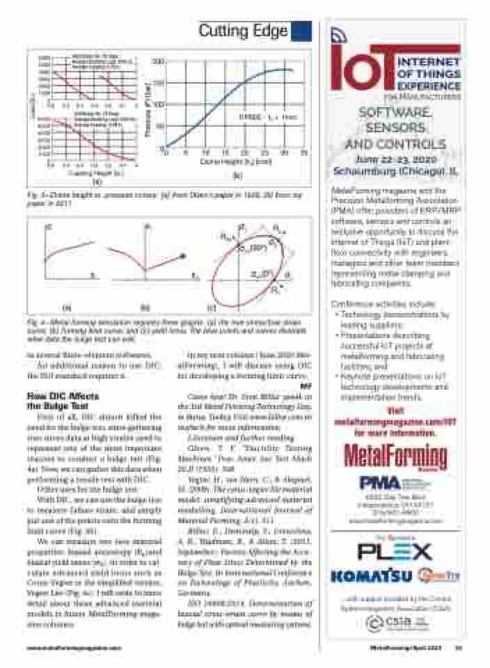

Hard Brass, No. 18 Gage. Average Breaking Load, 3000 lb. Average Cupping, 0.26 in.
200 150 100
50
   0.5 0.4
0.3 0.2
0.1 0
Soft Brass, No. 18 Gage. Average Breaking Load, 5600 lb. Average Cupping, 0.58 in.
DP600 - t 0
= 1mm
 0.5 0.4
Cupping Height [in.]
00 5 10 15 20 25 30 35 Dome Height (hd) [mm]
(b)
0.3 0.2 0.1 0 (a)
Fig. 3—Dome height vs. pressure curves: (a) from Olsen’s paper in 1920, (b) from my paper in 2011.
  σε1 σ2Rb
   R90
σun(90o) b
   (a)
(b)
(c)
ε
ε2
σ σun(0o) σ1
R0
Fig. 4—Metal forming simulation requires three graphs: (a) the true stress/true strain curve; (b) forming limit curve; and (c) yield locus. The blue points and curves illustrate what data the bulge test can add.
in several finite-element softwares. An additional reason to use DIC:
the ISO standard requires it.
How DIC Affects the Bulge Test
First of all, DIC almost killed the need for the bulge test, since gathering true stress data at high strains used to represent one of the most important reasons to conduct a bulge test (Fig. 4a). Now, we can gather this data when performing a tensile test with DIC.
Other uses for the bulge test:
With DIC, we can use the bulge test to measure failure strain, and simply put one of the points onto the forming limit curve (Fig. 4b).
We can measure two new material properties: biaxial anisotropy (Rb)and biaxial yield stress (σb), in order to cal- culate advanced yield locus such as Corus-Vegter or the simplified version, Vegter Lite (Fig. 4c). I will write in more detail about these advanced material models in future MetalForming maga- zine columns.
In my next column (June 2020 Met- alForming), I will discuss using DIC for developing a forming limit curve.
MF
