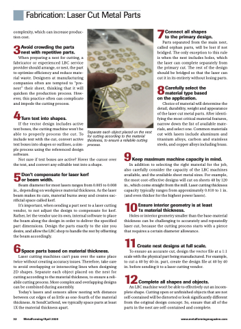

6Space parts based on material thickness. Laser cutting machines can’t pass over the same place twice without creating accuracy issues. Therefore, take care to avoid overlapping or intersecting lines when designing 2D shapes. Separate each object placed on the nest for cutting according to the material thickness, to ensure a reli- abile cutting process. More complex and overlapping designs can be combined during assembly.
Today’s lasers and sensors allow nesting wth distance between cut edges of as little as one-fourth of the material thickness. At SendCutSend, we typically space parts at least 1X the material thickness apart.

Separate each object placed on the nest for cutting according to the material thickness, to ensure a reliabile cutting process.
