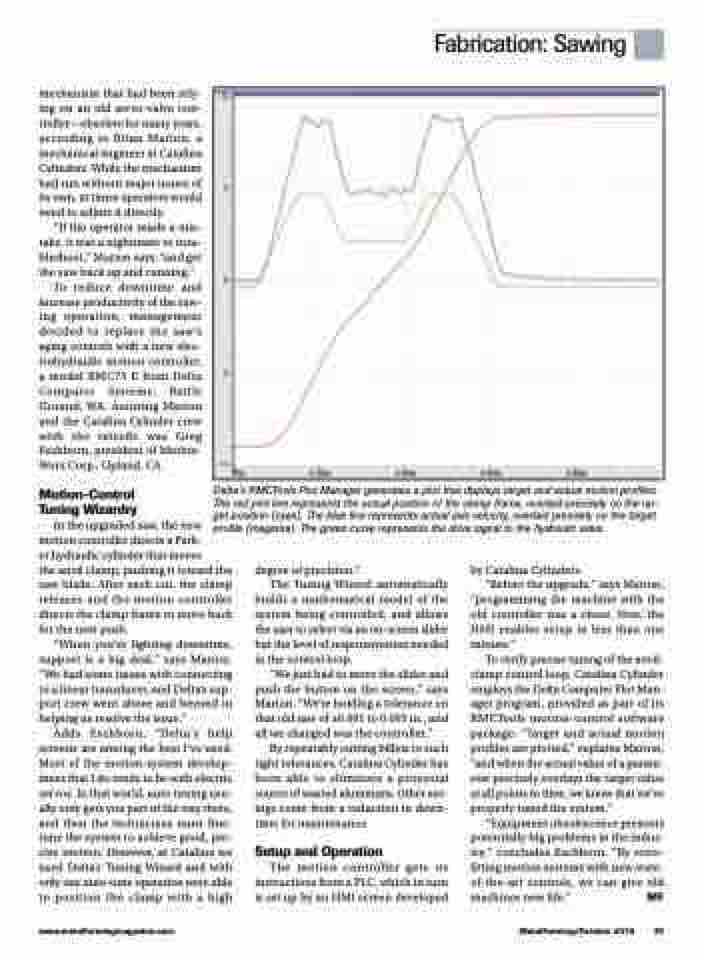

Delta’s RMCTools Plot Manager generates a plot that displays target and actual motion profiles. The red plot line represents the actual position of the clamp frame, overlaid precisely on the tar- get position (cyan). The blue line represents actual axis velocity, overlaid precisely on the target profile (magenta). The green curve represents the drive signal to the hydraulic valve.

Adds Eschborn, “Delta's help screens are among the best I’ve used. Most of the motion-system develop- ment that I do tends to be with electric servos. In that world, auto tuning usu- ally only gets you part of the way there, and then the technicians must fine- tune the system to achieve good, pre- cise motion. However, at Catalina we used Delta’s Tuning Wizard and with only one auto-tune operation were able to position the clamp with a high
degree of precision.”
The Tuning Wizard automatically
builds a mathematical model of the system being controlled, and allows the user to select via an on-screen slider bar the level of responsiveness needed in the control loop.
“We just had to move the slider and push the button on the screen,” says Marion. “We’re holding a tolerance on that old saw of ±0.001 to 0.003 in., and all we changed was the controller.”

To verify precise tuning of the anvil- clamp control loop, Catalina Cylinder employs the Delta Computer Plot Man- ager program, provided as part of its RMCTools motion-control software package. “Target and actual motion profiles are plotted,” explains Marion, “and when the actual value of a param- eter precisely overlays the target value at all points in time, we know that we’ve properly tuned the system.”
