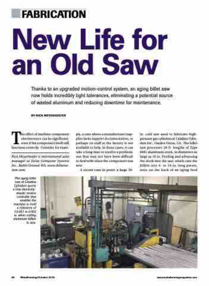

This aging billet saw at Catalina Cylinders sports a new electrohy- draulic motion controller that enables the machine to hold a tolerance of ±0.001 to 0.003 in. when cutting aluminum billets to size.
