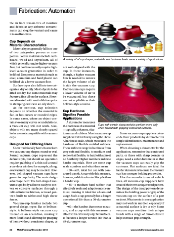

Vacuum-cup families include two general design types: flat or bellows- style. A bellows-style vacuum cup resembles an accordion, making it more flexible and allowing for grasping of items without consistent shapes, or
A variety of of cup shapes, materials and hardness levels serve a variety of applications.
not well-aligned with the cup. In these instances, though, a higher vacuum flow is needed to remove the larger volume of air inside the vacuum cup. Flat vacuum cups require a lower volume of air to be evacuated, but these are not as pliable as their bellows-style cousins.

Cups with certain characteristics perform more ably when tasked with gripping contoured surfaces.
