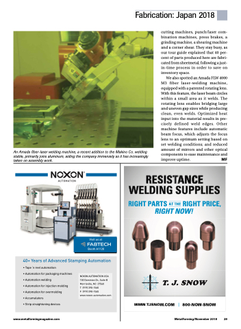

   An Amada fiber-laser welding machine, a recent addition to the Makino Co. welding stable, primarily joins aluminum, aiding the company immensely as it has increasingly taken on assembly work.

We also spotted an Amada FLW 4000 M3 fiber laser-welding machine, equipped with a patented rotating lens. With this feature, the laser beam circles within a small area as it welds. The rotating lens enables bridging large and uneven gap sizes while producing clean, even welds. Optimized heat input into the material results in pre- cisely defined weld edges. Other machine features include automatic beam focus, which adjusts the focus lens to an optimum setting based on set welding conditions; and reduced amount of mirrors and other optical components to ease maintenance and improve uptime. MF
