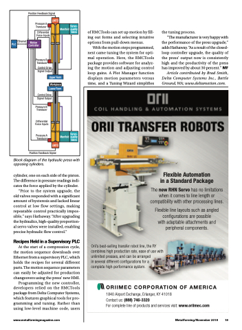

     Block diagram of the hydraulic press with opposing cylinders.
cylinder, one on each side of the piston. The difference in pressure readings indi- cates the force applied by the cylinder.
“Prior to the system upgrade, the old valves responded with a significant amount of hysteresis and lacked linear control at low flow settings, making repeatable control practically impos- sible,” says Hathaway. “After upgrading the hydraulics, high-quality proportion- al servo valves were installed, enabling precise hydraulic flow control.”
Recipes Held in a Supervisory PLC
At the start of a compression cycle, the motion sequence downloads over Ethernet from a supervisory PLC, which holds the recipes for several different parts. The motion sequence parameters can easily be adjusted for production changeovers using the press’ new HMI.
