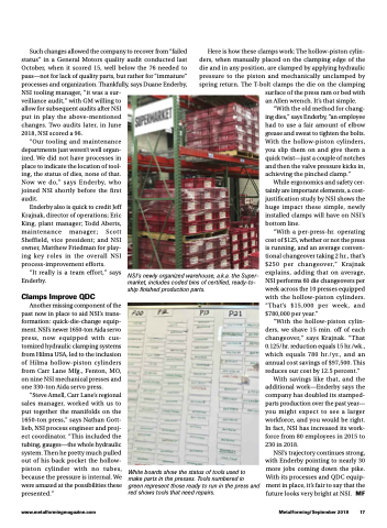

NSI’s newly organized warehouse, a.k.a. the Super- market, includes coded bins of certified, ready-to- ship finished production parts.
White boards show the status of tools used to make parts in the presses. Tools numbered in green represent those ready to run in the press and redshowstoolsthatneedrepairs.
