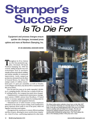

The Hilma hollow-piston cylinders shown here on this Aida 330T press at Northern Stamping are manually placed on the clamping edge of the dies and easily tightened with a few turns of an Allen wrench, enabling safe and simple die changes. The dies are clamped by applying hydraulic pressure to the pistons and mechanically unclamped by spring return. The T-bolt clamps the dies on the clamping surface of the press ram or bed.
