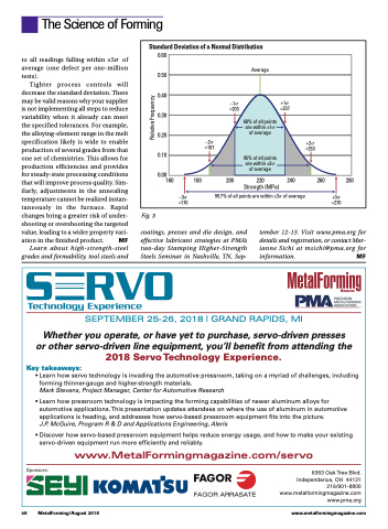

  Standard Deviation of a Normal Distribution
0.60 0.50 0.40 0.30 0.20 0.10 0.00
160
–3􏰀 =170
280
 Average
 –1􏰀 +1􏰀 =203 =237
 68% of all points are within ±1􏰀 of average
     –2􏰀 =187
+2􏰀 =253
 95% of all points are within ±2􏰀 of average
      180 200 220 240 260 Strength (MPa)
            99.7% of all points are within ±3􏰀 of average
+3􏰀 =270
to all readings falling within ±5􏰀 of average (one defect per one-million tests).

Fig. 3
