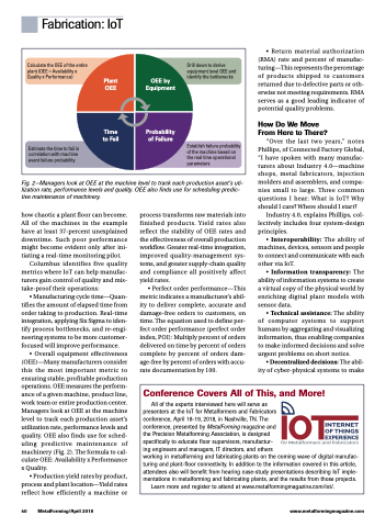

     Calculate the OEE of the entire plant (OEE = Availability x Quality x Performance)
Estimate the time to fail in correlation with machine event failure probability
Plant OEE
Time to Fail
OEE by Equipment
Probability of Failure
Drill down to derive equipment level OEE and identify the bottlenecks
Establish failure probability of the machine based on the real time operational parameters
      Fig. 2—Managers look at OEE at the machine level to track each production asset’s uti- lization rate, performance levels and quality. OEE also finds use for scheduling predic- tive maintenance of machinery.

• Overall equipment effectiveness (OEE)—Many manufacturers consider this the most important metric to ensuring stable, profitable production operations. OEE measures the perform- ance of a given machine, product line, work team or entire production center. Managers look at OEE at the machine level to track each production asset’s utilization rate, performance levels and quality. OEE also finds use for sched- uling predictive maintenance of machinery (Fig. 2). The formula to cal- culate OEE: Availability x Performance x Quality.
