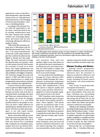

Fig. 1—This OEE graph charts downtime causes for seven machines in a plant, and illustrates how chaotic a plant floor can become. All of the machines in the example have at least 37-percent unexplained downtime. Such poor performance might become evident only after initiating a real-time monitoring pilot.

Referencing the accompanying graphic (Fig. 1), Columbus illustrates
