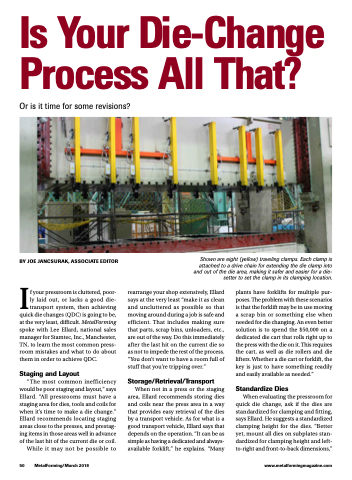

Shown are eight (yellow) traveling clamps. Each clamp is attached to a drive chain for extending the die clamp into and out of the die area, making it safer and easier for a die- setter to set the clamp in its clamping location.
