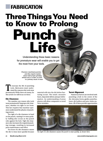

Precision-machined punches and dies require mainte- nance with proper grinding
wheels and a coolant, as heat is a primary cause of wear.

Die Clearance
The number-one reason why tools wear prematurely? Improper die clear- ance, whether too tight or too loose. This fact requires that machine oper- ators understand the physics of punch- ing presses.
Too tight of a die clearance is hard on the punch, causing it to wear quick- ly. Galling also occurs as the punch rubs against the hole. Tight die clear- ance also increases the required punch- ing tonnage, resulting in increased press maintenance and effort.
Too loose of a die clearance causes the die to wear more quickly because
material rolls into the die before frac- turing occurs. The result: excessive burrs, deposited debris and part defor- mation. An understanding of press physics will allow companies to avoid these mistakes.

Too tight of a die clearance causes the punch to wear quickly, as shown here.
