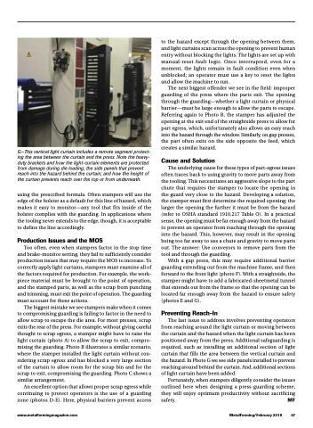

  G—This vertical light curtain includes a remote segment protect- ing the area between the curtain and the press. Note the heavy- duty brackets and how the light-curtain elements are protected from damage during die loading; the side panels that prevent reach into the hazard behind the curtain; and how the height of the curtain prevents reach over the top or from underneath.

The last issue to address involves preventing operators from reaching around the light curtain or moving between the curtain and the hazard when the light curtain has been positioned away from the press. Additional safeguarding is required, such as installing an additional section of light curtain that fills the area between the vertical curtain and the hazard. In Photo G we see side panels installed to prevent reaching around behind the curtain. And, additional sections of light curtain have been added.
