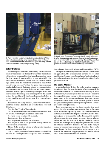

  Blanked area
  B—Here’s another case where a stamper has installed light cur- tains without considering scrap egress. Large areas of the cur- tains have been blanked to allow positioning of the scrap bin and for scrap to exit the press, compromising safety.

C—In this case, the stamper has set the hairpin guards wide open to allow the largest parts to escape. Once set in this location, they were never returned to a narrower opening. The resulting guarding scheme does not comply with the OSHA standard for barrier guards—an operator easily can reach through the window.
