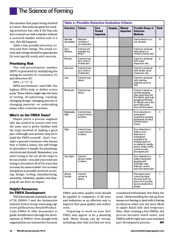

    Table 4—Possible-Detection Evaluation Criteria
 Detection
Criteria
Error- Proofed Inspection
Gauging
Manual Inspection
Possible Range of Detection Methods
Rank
Absolute Uncertainty
Absolute certainty of non-detection
Cannot detect or is not checked
10
Very Remote
Controls will probably not detect
Control is achieved with indirect or random checks only
9
Remote
Controls have poor chance of detection
Control is achieved with visual inspection only
8
Very Low
Control is achieved with double visual inspection only
7
Low
Controls may detect
Control is achieved with charting methods, such as SPC
6
Moderate
Controls may detect
Control is based on variable gauging after parts have left the station; go/no-go gauging performed on 100 percent of the parts after parts have left the station
5
Moderately High
Controls have a good chance to detect
Error detection in subsequent operations; gauging performed on setup and first-piece check
4
High
Error detection in- station; error detection in subsequent operations by multiple layers of acceptance: supply, select, install, verify; cannot accept discrepant part
3
Very High
Controls almost certain to detect
Error detection in- station (automatic gauging with automatic stop feature); cannot pass discrepant part
2
Almost Certain
Controls certain to detect
Discrepant parts cannot be made because item has been error-proofed by process/product design
1

Table 4 lists possible detection cri- teria and their ratings. The actual cri- teria and ratings should be appropriate for your specific needs and concerns.
Prioritizing Risk
The risk-prioritization number (RPN) is generated by multiplying the ratings for severity (S), occurrence (O) and detection (D):
RPN=S*O*D
RPNs vary between 1 and 1000. The highest RPNs help to define action areas. These efforts might take the form of testing, documenting, tracking, changing design, changing process or changing material—or undertaking many other corrective actions.
