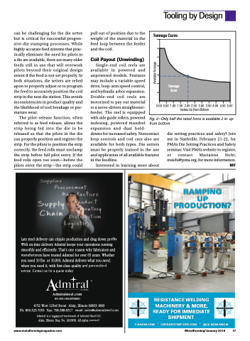

  Tonnage Curve
 Tonnage Zone
                   0.00 0.50 1.00 1.50 2.00 2.50 3.00 3.50 4.00 4.50 5.00 Inches Up From Bottom

Fig. 2—Only half the rated force is available 2 in. up from bottom
