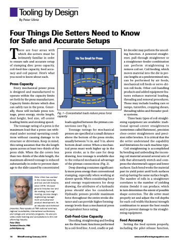

Fig. 1—Concentrated loads reduce press force capacity

                                                 The tonnage rating of a press is the maximum load that a press can with- stand under normal operating condi- tions without causing damage to its structure or drivetrain. Keep in mind, this rating assumes that the die length spans across at least two-thirds of the press slide. When the die covers less than two-thirds of the slide length, the maximum allowed tonnage is reduced substantially in order to prevent dam- age to the slide caused by concentrated

loads applied between the pitman con- nections (see Fig. 1).
Tonnage ratings for mechanical presses are specified at a small distance above the bottom of the press stroke, usually between 1⁄32 in. and 1⁄2 in. above bottom dead-center. When a mechan- ical press must work higher up in the press stroke, as is the case for deep drawing, less tonnage is available due to the reduced mechanical advantage of the pitman connections (Fig. 2).
Deep drawing consumes significant- ly more press energy than conventional stamping, especially when working at slower speeds. When considering force and energy requirements for deep drawing, the attributes of a hydraulic press should also be considered. Hydraulic presses provide maximum force throughout the entire stroke dis- tance and can provide higher forming- energy levels than a mechanical press of equivalent force rating.
