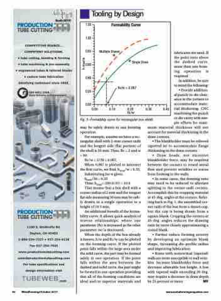

may be safely drawn in one forming operation.
For example, assume we have a rec- tangular shell with 2-mm corner radii and the longest side (flat portion) of theshellis30mm.Thus,Rc=2andw = 30:
Rc/w = 2/30 = 0.067,
When 0.067 is plotted to intersect the first curve, we find: hmax/w = 0.35,
Substituting for w gives:
hmax/30 = 0.35
Thus: hmax= (30)(0.35) = 10.5
That means that a box shell with a
corner radius of 2 mm and the longest flat side measuring 30 mm may be safe- ly drawn in a single operation to a height of 10.5 mm.
An additional benefit of the forma- bility curve: It allows quick analysis of inverse relationships, where one parameter (Rc) is increased as the other parameter (w) is decreased.
When the depth of the box already is known, h/w and Rc/w can be plotted on the forming curve. If the plotted point falls within the large area under the solid curve, the part may be formed safely in one operation. If the point falls within the area between the dashed and solid curve, the part might be formed in one operation providing that all of the forming conditions are ideal and/or superior materials and

lubricants are used. If the point rests above the dashed curve, more than one form- ing operation is required.

h-max/w
0.00
Rc/w = 0.067
0.10 0.20 0.30 Rc/w
0.40
Fig. 3—Formability curve for rectangular box shells
Single Draw
