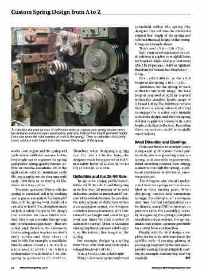

  To calculate the total amount of deflection within a compression spring (shown here), the designer considers three parameters: wire size, relaxed free length and solid height (wire size times the total number of coils in the spring). Then, to calculate total spring travel, subtract solid height from the relaxed free length of the spring.
