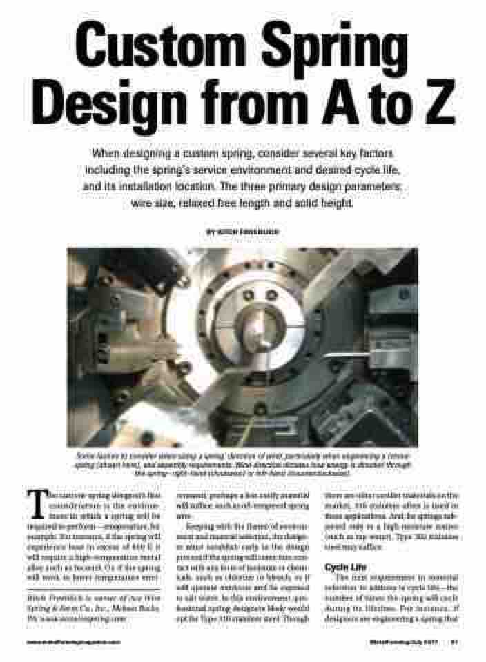

When designing a custom spring, consider several key factors including the spring’s service environment and desired cycle life, and its installation location. The three primary design parameters: wire size, relaxed free length and solid height.
BY RITCH FROEHLICH
Some factors to consider when sizing a spring: direction of wind, particularly when engineering a torsion spring (shown here), and assembly requirements. Wind direction dictates how energy is directed through the spring—right-hand (clockwise) or left-hand (counterclockwise).
