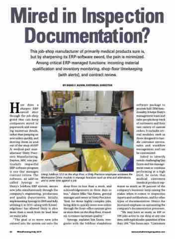

Using JobBoss 12.0 on the shop floor, a Unity Precision employee accesses the Workstation Driver module to manage functions such as time and attendance, and to enter time against a job.
