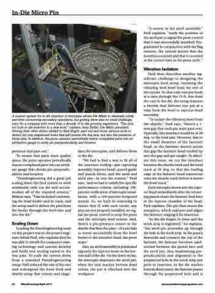

In-Die Micro Pin
  A custom system for in-die insertion of micropins allows Die-Matic to eliminate costly and time-consuming secondary operations, but getting there was no small challenge, even for a company with more than a decade of in-die-process experience. “This proj- ect took in-die insertion to a new level,” explains Jerry Zeitler, Die-Matic president. Among their other duties related to feed length, part-out and more, sensors work to detect not only prepierced holes that will receive the tiny pins, but also the presence of those pins. In addition, the press operator periodically inserts completed parts into an attribution gauge to verify pin perpendicularity and location.
“A sensor in the anvil assembly,” Patil explains, “reads the position of the anvil pin to signal the press control that it was successfully installed. Pro- grammed in conjunction with the flag sensors, the system knows that the insertion occurred and that it occurred at the correct time in the press cycle.”

Patil then describes another sig- nificant challenge to designing the micropin feed setup: isolating the vibrating feed bowl from the rest of the circuit. So that only one pin feeds at a time through the 15-ft. line from the cart to the die, the setup features a shuttle that delivers one pin at a time from the bowl to injector-head assembly.
“To isolate the vibratory bowl from the shuttle,” Patil says, “there’s a 1- mm gap that each pin must pass over. Typically, this interface would be at 90 deg. to the feed axis. However, due to the small diameter of the fastener head, as the fastener moved across this gap the fastener head tended tip into the gap and get caught. To allevi- ate this issue, we cut the interface between the shuttle track and the bowl track at 45 deg. so that the leading edge of the fastener head transitions onto the shuttle track before it leaves the bowl track.”
