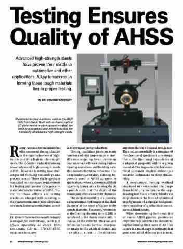

Sheetmetal-testing machines, such as this BUP 1000 from Zwick/Roell with an Aramis optical 3D deformation-analysis system installed, are used by automakers and others to assess the formability of advanced high-strength steels.
