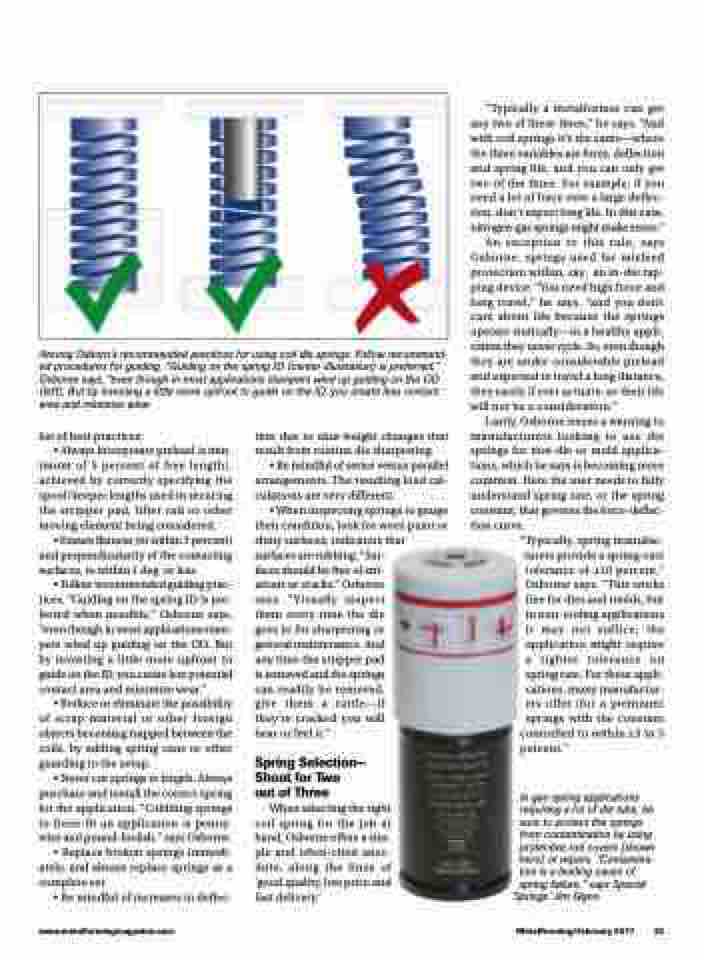

 Among Osborn’s recommended practices for using coil die springs: Follow recommend- ed procedures for guiding. “Guiding on the spring ID (center illustration) is preferred,” Osborne says, “even though in most applications stampers wind up guiding on the OD (left). But by investing a little more upfront to guide on the ID, you create less contact area and minimize wear.

In gas-spring applications requiring a lot of die lube, be sure to protect the springs from contamination by using protective rod covers (shown here) or wipers. “Contamina- tion is a leading cause of spring failure,” says Special
Springs’ Jim Glynn.

• Follow recommended guiding prac- tices. “Guiding on the spring ID is pre- ferred when possible,” Osborne says, “even though in most applications stam- pers wind up guiding on the OD. But by investing a little more upfront to guide on the ID, you create less potential contact area and minimize wear.”
