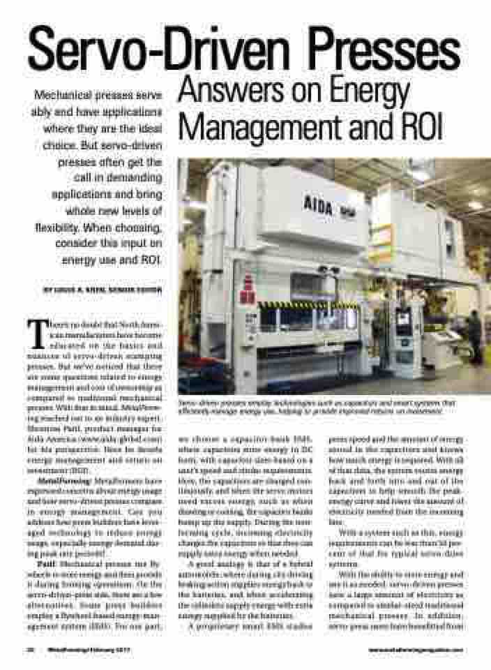

Servo-driven presses employ technologies such as capacitors and smart systems that efficiently manage energy use, helping to provide improved returns on investment.
we choose a capacitor-bank EMS, where capacitors store energy in DC form, with capacitor sizes based on a user’s speed and stroke requirements. Here, the capacitors are charged con- tinuously, and when the servo motors need excess energy, such as when drawing or coining, the capacitor banks bump up the supply. During the non- forming cycle, incoming electricity charges the capacitors so that they can supply extra energy when needed.
A good analogy is that of a hybrid automobile, where during city driving braking action supplies energy back to the batteries, and when accelerating the cylinders supply energy with extra energy supplied by the batteries.
A proprietary smart EMS studies
press speed and the amount of energy stored in the capacitors and knows how much energy is required. With all of that data, the system routes energy back and forth into and out of the capacitors to help smooth the peak- energy curve and lower the amount of electricity needed from the incoming line.
With a system such as this, energy requirements can be less than 50 per- cent of that for typical servo-drive systems.
