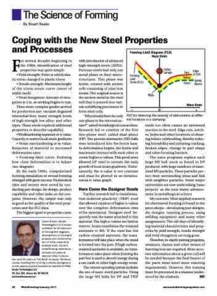

  Forming-Limit Diagram (FLD) Major Strain
 Forming- Limit
Curve (FLC)
FLC0
Failed Edge
Sample
Red of Cliff Yellow
Safety Green Barrier
Minor Strain
 –0+

• Forming-limit curve: Defining
how close deformation is to failure (see diagram).

FLC for deterring the severity of deformation at differ- ent locations in a stamping.
