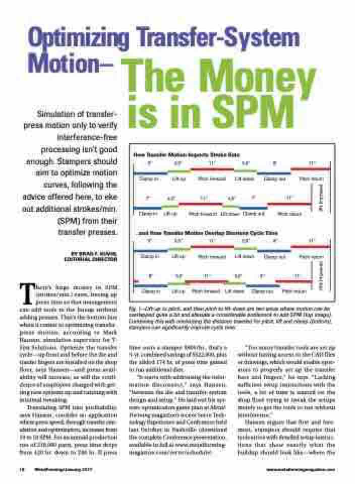

Fig. 1—Lift-up to pitch, and then pitch to lift-down are two areas where motion can be overlapped quite a bit and alleviate a considerable bottleneck to add SPM (top image). Combining this with minimizing the distance traveled for pitch, lift and clamp (bottom), stampers can significantly improve cycle time.

  How Transfer Motion Impacts Stroke Rate
8"
Clamp in
7"
Clamp in
5.5"
Lift up
4.5"
Lift up
11"
Pitch forward
11"
5.5" Lift down
4.5" 7"
8" 11" Clamp out Pitch return
11"
         Pitch forward Lift down Clamp out Pitch return
...and How Transfer Motion Overlap Shortens Cycle Time
8" Clamp in
8" Clamp in
5.5" Lift up
5.5" Lift up
11" Pitch forward
5.5" Lift down
8" Clamp out
11" Pitch return
 11"
5.5"
8"
11"
