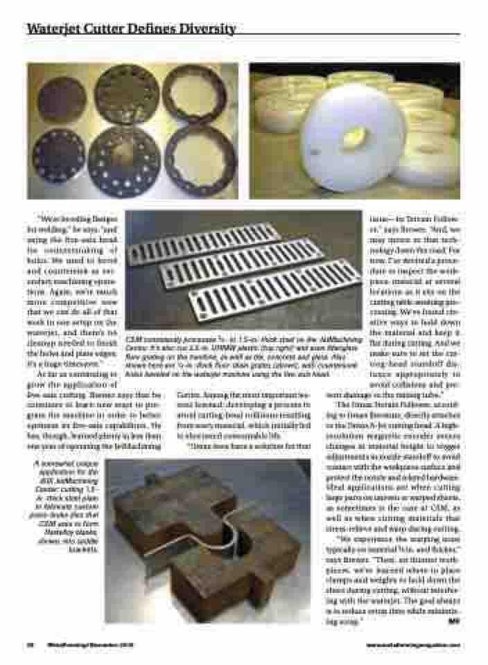

    “We’re beveling flanges for welding,” he says, “and using the five-axis head for countersinking of holes. We used to bevel and countersink as sec- ondary machining opera- tions. Again, we’re much more competitive now that we can do all of that work in one setup on the waterjet, and there’s no cleanup needed to finish the holes and plate edges; it’s a huge timesaver.”
CSM consistently processes 3⁄4- to 1.5-in.-thick steel on the JetMachining Center. It’s also cut 2.5-in, UHMW plastic (top right) and even fiberglass floor grating on the machine, as well as tile, concrete and glass. Also shown here are 1⁄4-in.-thick floor-drain grates (above), with countersunk holes beveled on the waterjet machine using the five-axis head.

 A somewhat unique application for the 80X JetMachining
Center: cutting 1.5- in.-thick steel plate to fabricate custom press-brake dies that CSM uses to form Hastelloy blanks, shown, into saddle brackets.
