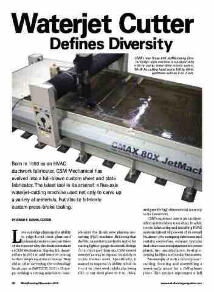

Less cut-edge cleanup, the ability to edge-bevel thick plate and increased precision are just three of the reasons why the decisionmakers at CSM Mechanical, Topeka, KS, decid- ed late in 2015 to add waterjet cutting to their shop’s equipment lineup. They did so after surveying the technology landscape at FABTECH 2015 in Chica- go, seeking a cutting solution to com-
plement the firm’s new plasma-arc- cutting (PAC) machine. Believing that the PAC machine is perfectly suited for cutting lighter-gauge ductwork fittings (1⁄2 in. thick and thinner), CSM viewed waterjet as way to expand its ability to tackle thicker work. Specifically, it wanted to improve its ability to bid on 1- to 2-in. plate work, while also being able to cut steel plate to 6 in. thick,
36 MetalForming/November 2016
CSM’s new Omax 80X JetMachining Cen- ter bridge-style machine is equipped with a 50-hp pump, linear-drive motion system, Tilt-A-Jet cutting head and a 180 by 90-in. worktable with an 8-in. Z axis.
