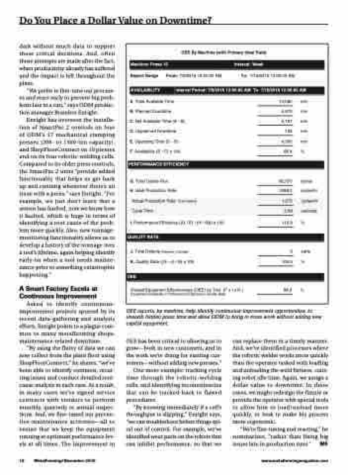

   Machine: Press 15 -- Interval: Week
 AVAILABILITY
 Interval Period: 7/3/2016 12:00:00 AM To 7/10/2016 12:00:00 AM
 PERFORMANCE EFFICIENCY
QUALITY RATE
OEE
  Actual Production Rate (Calculated) 1,272 cycles/hr Cycle Time 2.83 seconds

OEE By Machine (with Primary Ideal Rate)
From: 7/3/2016 12:00:00 AM A. Total Available Time
B. Planned Downtime
C. Net Available Time (A - B) D. Unplanned Downtime
E. Operating Time (C - D)
F. Availability (E / C) x 100
G. T otal Cycles Run
H. Ideal Production Rate
I. Performance Efficiency ((G / E) / (H / 60)) x 100
J. Total Defects (Rework + Scrap)
K. Quality Rate ((G - J) / G) x 100
Overall Equipment Effectiveness (OEE) by Tool (F x I x K ) Equipment Availability x Performance Efficiency x Quality Rate
Report Range
To: 7/10/2016 12:00:00 AM 10,080 min
4,979 min 5,101 min 745 min 4,356 min
85.4 %
92,370 cycles 1098.0 cycles/hr
115.9 %
0 parts 100.0 %
98.9 %
             18 MetalForming/November 2016
OEE reports, by machine, help identify continuous-improvement opportunities, to unearth hidden press time and allow ODM to bring in more work without adding new capital equipment.
