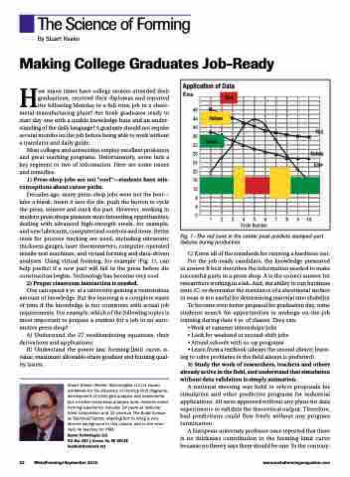

Decades ago, many press-shop jobs were not the best— lube a blank, insert it into the die, push the button to cycle the press, remove and stack the part. However, working in modern press shops presents more interesting opportunities, dealing with advanced high-strength steels, for example, and new lubricants, computerized controls and more. Better tools for process tracking are used, including ultrasonic thickness gauges, laser thermometers, computer-operated tensile-test machines, and virtual forming and data-driven analyses. Using virtual forming, for example (Fig. 1), can help predict if a new part will fail in the press before die construction begins. Technology has become very cool.

Fig. 1—The red zone in the center peak predicts stamped-part failures during production.
