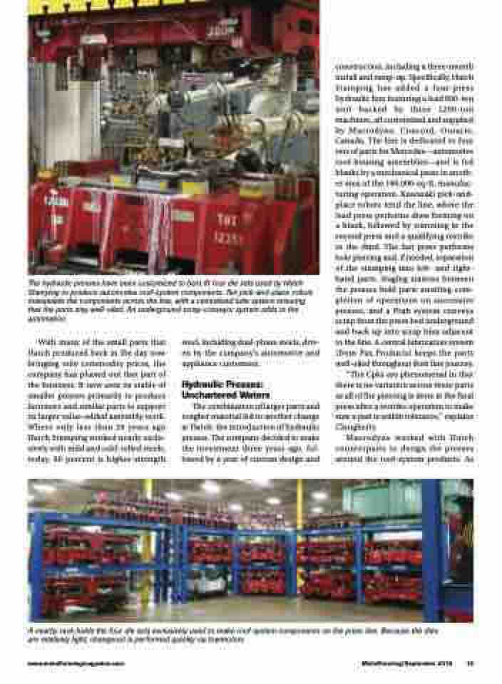

The hydraulic presses have been customized to best fit four die sets used by Hatch Stamping to produce automotive roof-system components. Ten pick-and-place robots manipulate the components across the line, with a centralized lube system ensuring that the parts stay well-oiled. An underground scrap-conveyor system adds to the automation.
construction, including a three-month install and ramp-up. Specifically, Hatch Stamping has added a four-press hydraulic line featuring a lead 600-ton unit backed by three 1200-ton machines, all customized and supplied by Macrodyne, Concord, Ontario, Canada. The line is dedicated to four sets of parts for Mercedes—automotive roof-housing assemblies—and is fed blanks by a mechanical press in anoth- er area of the 160,000-sq-ft. manufac- turing operation. Kawasaki pick-and- place robots tend the line, where the lead press performs draw forming on a blank, followed by trimming in the second press and a qualifying restrike in the third. The last press performs hole piercing and, if needed, separation of the stamping into left- and right- hand parts. Staging stations between the presses hold parts awaiting com- pletion of operations on successive presses, and a Prab system conveys scrap from the press bed underground and back up into scrap bins adjacent to the line. A central lubrication system (from Pax Products) keeps the parts well-oiled throughout their line journey.

 A nearby rack holds the four die sets exclusively used to make roof-system components on the press line. Because the dies are relatively light, changeout is performed quickly via towmotors.
