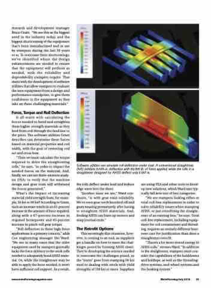

“Roll deflection in these high-force applications is a primary concern,” adds Coe engineering manager Jim Ward. “We see in many cases that the older equipment used by stampers generally lacks the force delivery to the work rolls needed to adequately bend AHSS mate- rial. Or, while the straightener may be able to apply the force needed, it won’t have sufficient roll support. As a result,
Software utilities can simulate roll deflection under load. A conventional straightener (left) exhibits 0.049-in. deflection with 60,000 lb. of force applied, while the rolls in a straightener designed for AHSS deflect only 0.007 in.

the rolls deflect under load and induce edge wave into the sheet.
