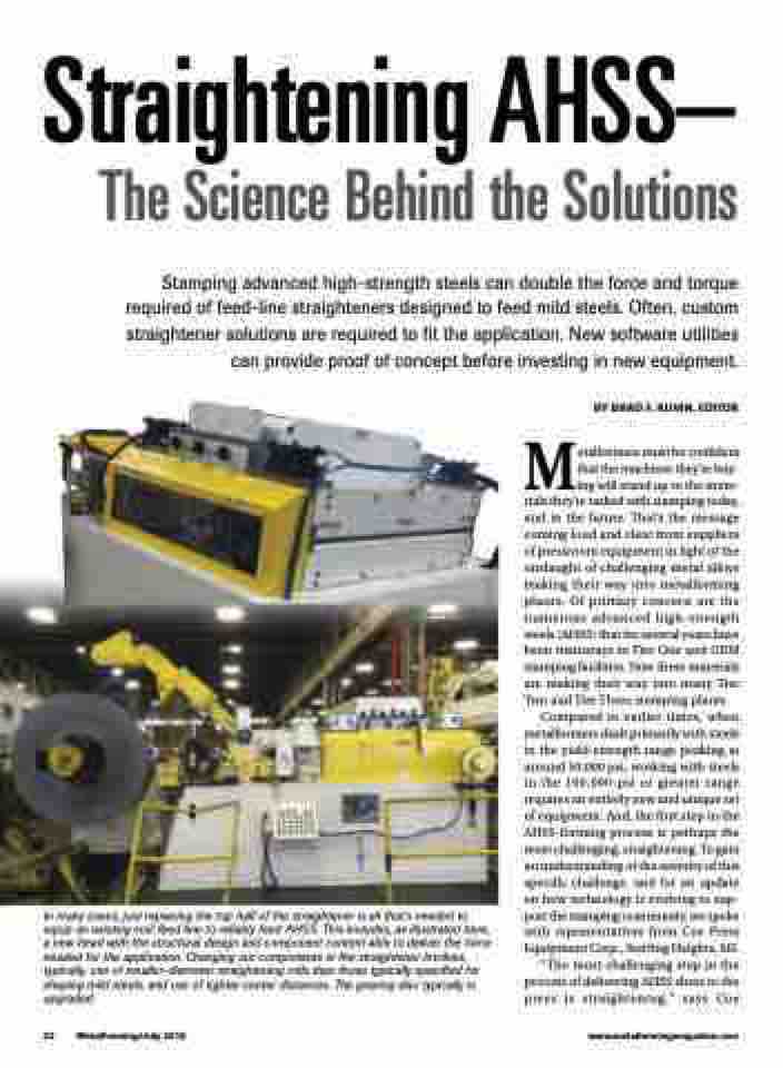

  In many cases, just replacing the top half of the straightener is all that’s needed to equip an existing coil-feed line to reliably feed AHSS. This includes, as illustrated here, a new head with the structural design and component content able to deliver the force needed for the application. Changing out components in the straightener involves, typically, use of smaller-diameter straightening rolls than those typically specified for shaping mild steels, and use of tighter center distances. The gearing also typically is upgraded.
