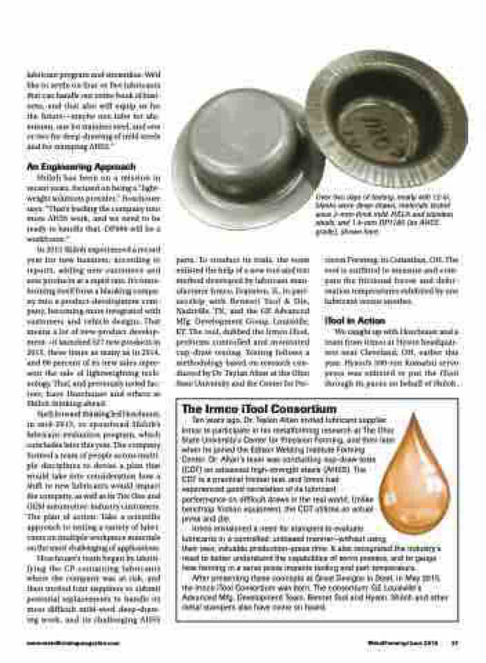

Over two days of testing, nearly 400 12-in. blanks were deep-drawn; materials tested were 2-mm-thick mild, HSLA and stainless steels, and 1.4-mm DP1180 (an AHSS grade), shown here.
cision Forming, in Columbus, OH. The tool is outfitted to measure and com- pare the frictional forces and defor- mation temperatures exhibited by one lubricant versus another.
