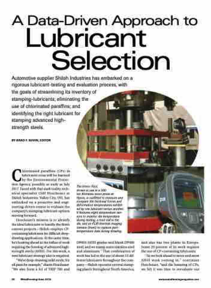

The Irmco iTool,
shown in use in a 300-
ton Komatsu servo press at
Hyson, is outfitted to measure and compare the frictional forces and deformation temperatures exhibit- ed by one lubricant versus another. It features eight temperature sen- sors to monitor die temperature during testing, a load cell in the die, and an FLIR thermal-imaging camera (inset) to capture part- temperature data during drawing.
