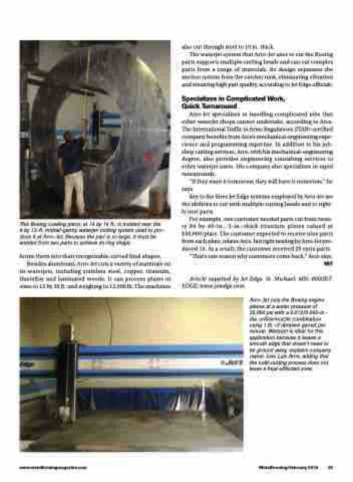

  This Boeing cowling piece, at 14 by 14 ft., is hoisted near the 8 by 13-ft. midrail-gantry waterjet-cutting system used to pro- duce it at Arro-Jet. Because the part is so large, it must be welded from two parts to achieve its ring shape.
forms them into their recognizable curved final shapes. Besides aluminum, Arro-Jet cuts a variety of materials on its waterjets, including stainless steel, copper, titanium, Hastelloy and laminated woods. It can process plates in sizes to 12 by 30 ft. and weighing to 12,000 lb. The machines
also cut through steel to 10 in. thick.
The waterjet system that Arro-Jet uses to cut the Boeing
parts supports multiple cutting heads and can cut complex parts from a range of materials. Its design separates the motion system from the catcher tank, eliminating vibration and ensuring high part quality, according to Jet Edge officials.

Arro-Jet cuts the Boeing engine pieces at a water pressure of 55,000 psi with a 0.012/0.045-in.- dia. orifice/nozzle combination using 1 lb. of abrasive garnet per minute. Waterjet is ideal for this application because it leaves a smooth edge that doesn’t need to be ground away, explains company owner Jose Luis Arce, adding that the cold-cutting process does not leave a heat-affected zone.
