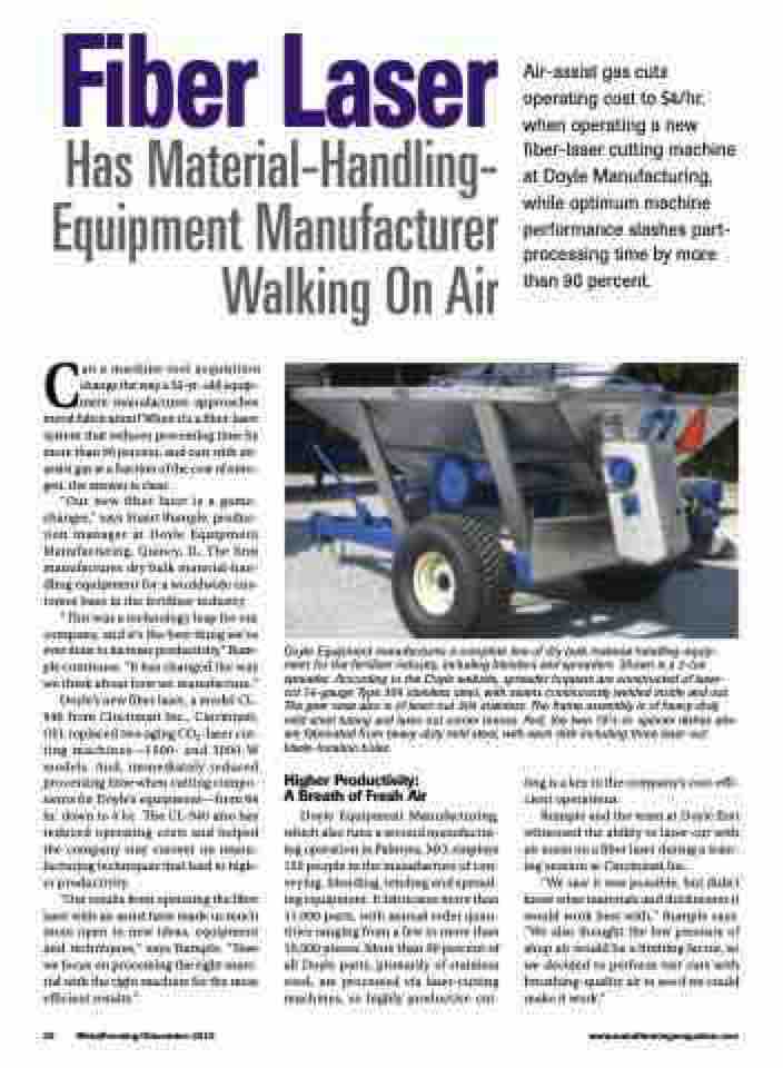

Doyle Equipment manufactures a complete line of dry bulk material handling-equip- ment for the fertilizer industry, including blenders and spreaders. Shown is a 2-ton spreader. According to the Doyle website, spreader hoppers are constructed of laser- cut 14-gauge Type 304 stainless steel, with seams continuously welded inside and out. The gear case also is of laser-cut 304 stainless. The frame assembly is of heavy-duty mild-steel tubing and laser-cut corner braces. And, the twin 191⁄4-in. spinner dishes also are fabricated from heavy-duty mild steel, with each dish including three laser-cut blade-location holes.
