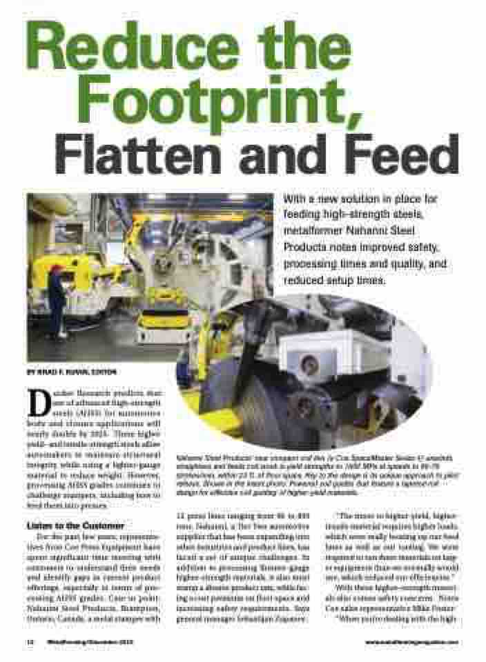

With a new solution in place for feeding high-strength steels, metalformer Nahanni Steel Products notes improved safety, processing times and quality, and reduced setup times.
Nahanni Steel Products’ new compact coil line (a Coe SpaceMaster Series 4) unwinds, straightens and feeds coil stock in yield strengths to 1000 MPa at speeds to 60-70 strokes/min, within 23 ft. of floor space. Key to the design is its unique approach to pilot release. Shown in the insert photo: Powered coil guides that feature a tapered roll design for effective coil guiding of higher-yield materials.
