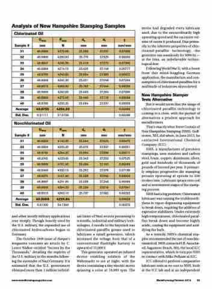

Analysis of New Hampshire Stamping Samples

    Chlorinated Oil ε mm/mm
  31
32
33
34
35
36
37
38
39
40
Average
Std. Dev.
Umax
49.9669
49.9847
49.9694
49.9796
49.9948
49.9618
49.9669
49.9669
49.9796
49.9755
0.01111
Pmax
4280.90
4245.30
4214.15
4240.85
4245.30
4369.90
4240.85
4272.00
4205.25
4254.20
51.0158
do
25.770
25.419
25.425
25.604
25.221
25.745
25.460
25.442
25.564
df
 Sample #
mm
49.9669
N
4272.00
mm
25.389
mm
27.257
27.329
27.272
27.148
27.389
27.048
27.444
27.264
27.118
27.337
0.07358
0.06050
0.07290
0.06777
0.06972
0.07244
0.06599
0.07086
0.06588
0.06936
0.06936
0.00268
                                   Nonchlorinated Oil ε mm/mm
  31
32
33
34
35
36
37
38
39
40
Average
Std. Dev.
Umax
49.9694
49.9745
49.9745
49.9669
49.9466
49.9974
49.9897
49.9669
49.9516
49.9669
0.01330
Pmax
4205.25
4254.20
4223.05
4191.90
4303.15
4191.90
4231.95
4294.25
4263.10
4235.84
54.1594
do
25.675
25.554
25.343
25.494
25.262
25.536
25.538
25.239
25.737
df
 Sample #
mm
49.9694
N
4142.95
mm
25.944
mm
27.624
27.357
27.090
27.250
27.143
27.078
27.045
27.248
27.016
27.382
0.06475
0.06551
0.06011
0.07525
0.06468
0.07189
0.05909
0.06696
0.07041
0.06392
0.06603
0.00373
