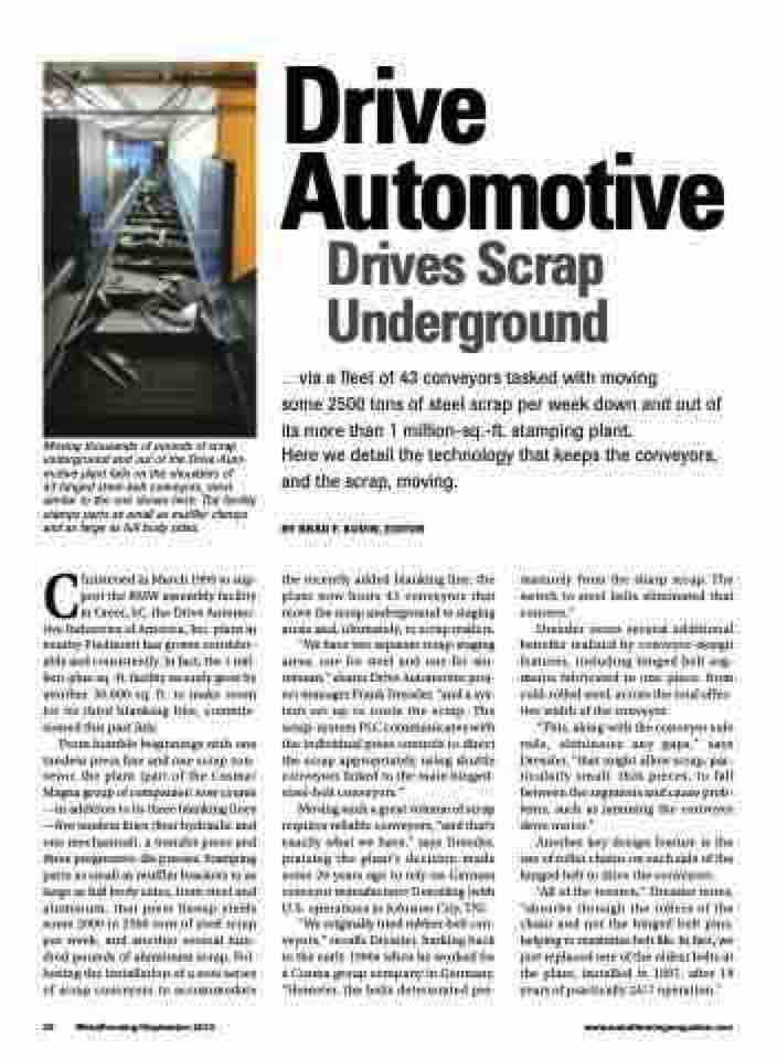

 Moving thousands of pounds of scrap underground and out of the Drive Auto- motive plant falls on the shoulders of
43 hinged steel-belt conveyors, most similar to the one shown here. The facility stamps parts as small as muffler clamps and as large as full body sides.
