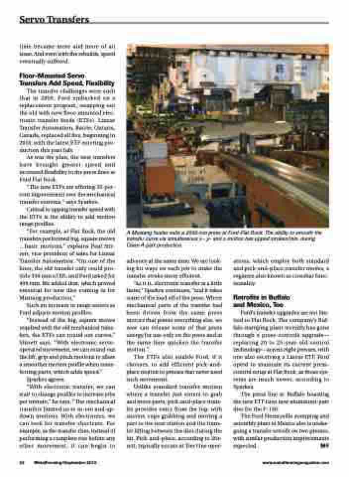

A Mustang fender exits a 2000-ton press at Ford-Flat Rock. The ability to smooth the transfer curve via simultaneous x-, y- and z-motion has upped strokes/min. during Class-A part production.
