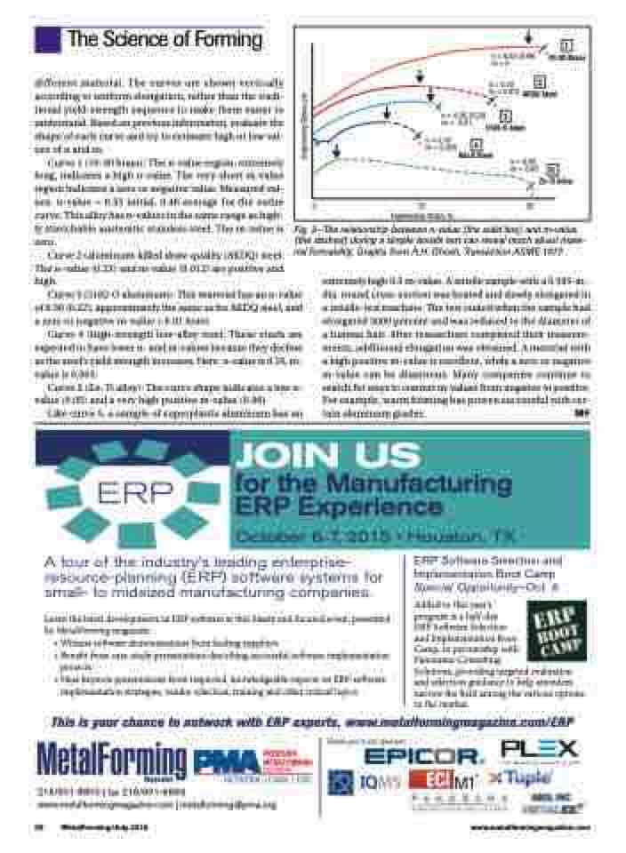

different material. The curves are shown vertically according to uniform elongation, rather than the tradi- tional yield-strength sequence to make them easier to understand. Based on previous information, evaluate the shape of each curve and try to estimate high or low val- ues of n and m.
Curve 1 (70-30 brass): The n-value region, extremely long, indicates a high n-value. The very-short m-value region indicates a zero or negative value. Measured val- ues: n-value = 0.55 initial, 0.46 average for the entire curve. This alloy has n-values in the same range as high- ly stretchable austenitic stainless steel. The m-value is zero.
Curve 2 (aluminum-killed draw-quality (AKDQ) steel: The n-value (0.23) and m-value (0.012) are positive and high.
Fig. 3—The relationship between n-value (the solid line) and m-value (the dashed) during a simple tensile test can reveal much about mate- rial formability. Graphs from A.H. Ghosh, Transaction ASME 1977.
Curve 3 (5182-O aluminum): This material has an n-value of 0.36 (0.22), approximately the same as for AKDQ steel, and a zero or negative m-value (-0.01 here).
Curve 4 (high-strength low-alloy steel: These steels are expected to have lower n- and m-values because they decline as the steel’s yield strength increases. Here, n-value is 0.16, m- value is 0.005.
Curve 5 (Zn-Ti alloy): The curve shape indicates a low n- value (0.05) and a very high positive m-value (0.06).
