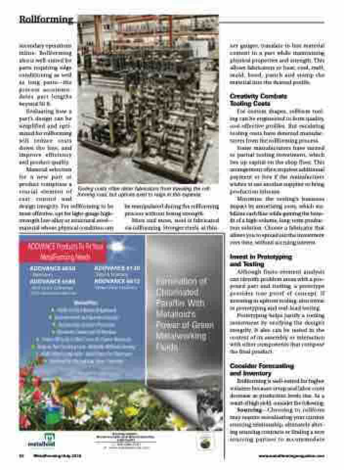

Tooling costs often deter fabricators from traveling the roll- forming road, but options exist to reign in this expense.
