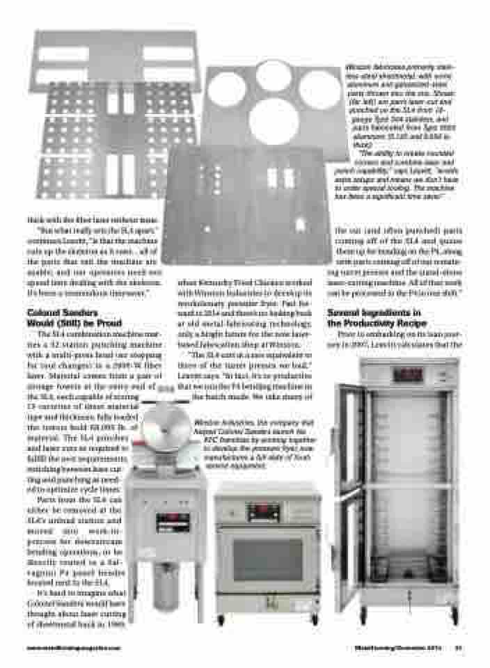

Winston fabricates primarily stain- less-steel sheetmetal, with some aluminum and galvanized-steel
parts thrown into the mix. Shown (far left) are parts laser-cut and punched on the SL4 from 18-
gauge Type 304 stainless, and parts fabricated from Type 3003 aluminum (0.125 and 0.090 in. thick).
“The ability to create rounded corners and combine laser and
punch capability,” says Leavitt, “avoids extra setups and means we don’t have to order special tooling. The machine has been a significant time saver.”
