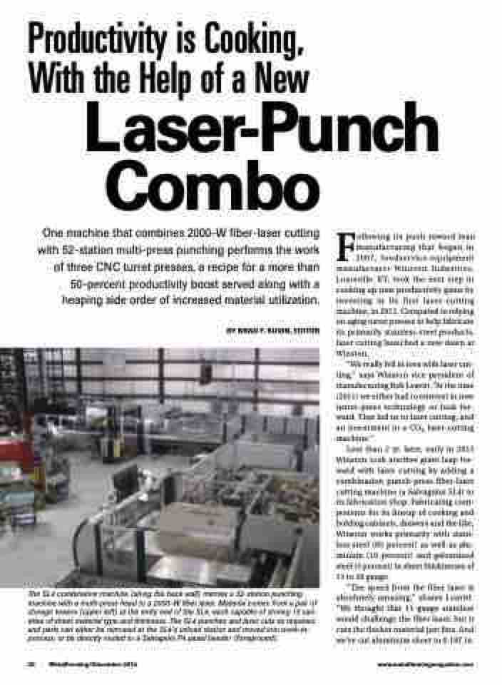

 The SL4 combination machine (along the back wall) marries a 52-station punching machine with a multi-press head to a 2000-W fiber laser. Material comes from a pair of storage towers (upper left) at the entry end of the SL4, each capable of storing 15 vari- eties of sheet material type and thickness. The SL4 punches and laser cuts as required, and parts can either be removed at the SL4’s unload station and moved into work-in- process, or be directly routed to a Salvagnini P4 panel bender (foreground).
