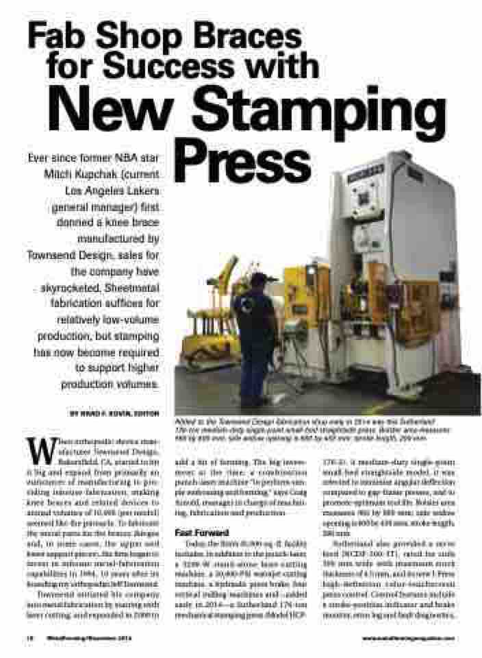

Added to the Townsend Design fabrication shop early in 2014 was this Sutherland 176-ton medium-duty single-point small-bed straightside press. Bolster area measures 960 by 800 mm; side widow opening is 600 by 450 mm; stroke length, 200 mm.

Today, the firm’s 45,000-sq.-ft. facility includes, in addition to the punch-laser, a 3200-W stand-alone laser-cutting machine, a 50,000-PSI waterjet-cutting machine, a hydraulic press brake, four vertical milling machines and—added early in 2014—a Sutherland 176-ton mechanical stamping press (Model HCP-
176-2). A medium-duty single-point small-bed straightside model, it was selected to minimize angular deflection compared to gap-frame presses, and to promote optimum tool life. Bolster area measures 960 by 800 mm; side widow opening is 600 by 450 mm; stroke length, 200 mm.
Sutherland also provided a servo feed (NCDF-300-3T), rated for coils 300 mm wide with maximum stock thickness of 4.5 mm, and its new I-Press high-definition color-touchscreen press control. Control features include a stroke-position indicator and brake monitor, error log and fault diagnostics,
